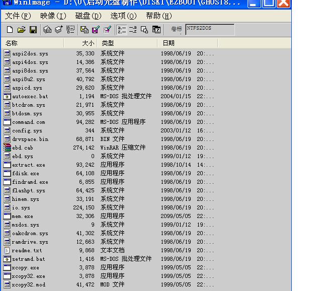

自己拿超级GHOSTXP第六版的启动光盘想改做自己的启动光盘。如下
先用UltraISO做别人的启动光盘的镜像文件。打开它,加入一个工具(DISKGEN)。放在和GHOST80同一个目录下。GHOST80是原来有的。我给DISKGEN做了个DISKGEN.IMG。也是放在GHOST80.IMG同一个目录下,可是DISKGEN却不能在启动光盘中启动。这是怎么回来啊。我是大菜鸟,这样做能行吗?到底要怎样设置才能啊。请各位大虾们帮帮忙啊。小弟感激不尽!!
对IMG中的AUTOEXEC.BAT和CONFIG.SYS设置如下。
★★★GHOST80的AUTO:
@ECHO OFF
set EXPAND=YES
SET DIRCMD=/O:N
cls
call setramd.bat %LglDrv%
set temp=c:\
set tmp=c:\
path=%RAMD%:\;a:\;%CDROM%:\
copy command.com %RAMD%:\ > NUL
set comspec=%RAMD%:\command.com
copy extract.exe %RAMD%:\ > NUL
copy readme.txt %RAMD%:\ > NUL
:ERROR
IF EXIST ebd.cab GOTO EXT
echo Please insert Windows 98 Startup Disk 2
echo.
pause
GOTO ERROR
:EXT
echo.
IF "%config%"=="HELP" GOTO HELP
LH %ramd%:\MSCDEX.EXE /D:mscd001 /L:%CDROM%
echo.
GOTO QUIT
:HELP
cls
call help.bat
echo Your computer will now restart and the startup menu will appear.
echo.
echo.
echo.
echo.
echo.
echo.
echo.
echo.
echo.
echo.
restart.com
GOTO QUIT
:QUIT
echo To get help, type HELP and press ENTER.
echo.
rem Clean up environment variables
rem set CDROM=
rem set LglDrv=
%CDROM%:
CD\TOOLS
GHOST80 -clone,mode=pload,src=CDROM.gho:1,dst=1:1 -sure -rb
★★★GHOST80的CONFIG.EXE:
device=himem.sys /testmem:off
device=btdosm.sys
device=flashpt.sys
device=btcdrom.sys /D:mscd001
device=aspi2dos.sys
device=aspi8dos.sys
device=aspi4dos.sys
device=aspi8u2.sys
device=aspicd.sys /D:mscd001
files=10
buffers=10
dos=high,umb
stacks=9,256
devicehigh=ramdrive.sys /E 2048
lastdrive=z

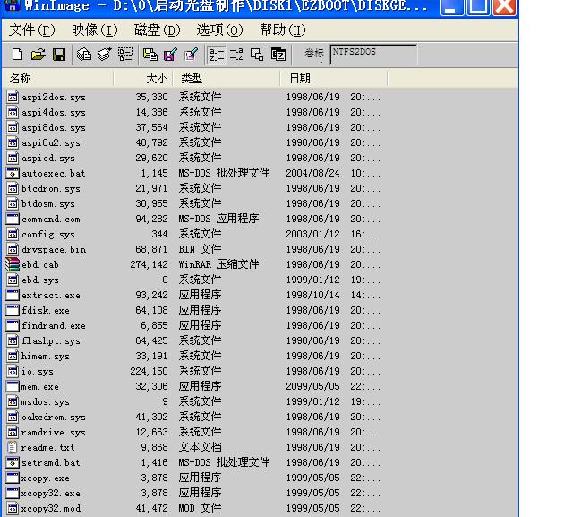

★★★DISKGEN的AUTOEXEC.COM
@ECHO OFF
set EXPAND=YES
SET DIRCMD=/O:N
cls
set temp=c:\
set tmp=c:\
:ERROR
echo.
pause
GOTO ERROR
:EXT
echo.
echo.
GOTO QUIT
:HELP
cls
call help.bat
echo.
echo.
echo.
echo.
echo.
echo.
echo.
echo.
echo.
echo.
restart.com
GOTO QUIT
:QUIT
echo.
rem set CDROM=
rem set LglDrv=
%CDROM%:
CD\TOOLS\DISKGEN.EXE
★★★DISKGEN的CONFIG.SYS
device=btdosm.sys
device=flashpt.sys
device=aspi2dos.sys
device=aspi8dos.sys
device=aspi4dos.sys
device=aspi8u2.sys
files=10
buffers=10
dos=high,umb
stacks=9,256
lastdrive=z
[求助]关于做启动光盘的问题。头晕中,(64版主能再进来一下吗?)
[这个贴子最后由rainyblue在 2004/08/24 04:53pm 第 1 次编辑]

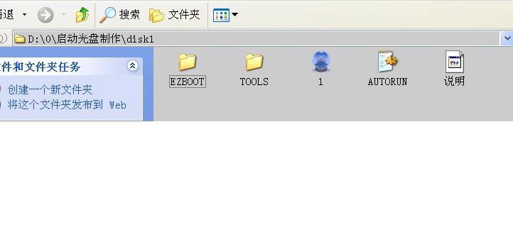

启动盘目录

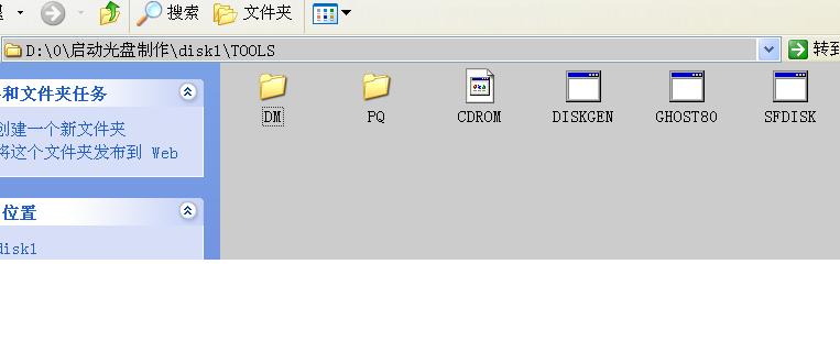

工具所在位置
GHOST.IMG的内容
DISKGEN.IMG的内容

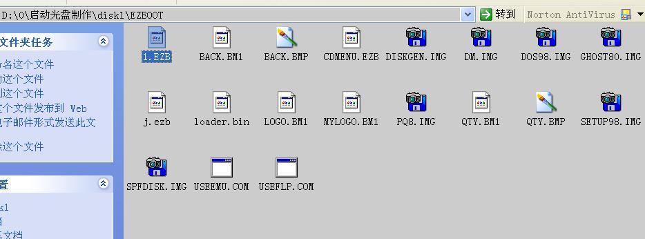

FZBOOT内的文件
[这个贴子最后由rainyblue在 2004/08/24 05:04pm 第 1 次编辑]

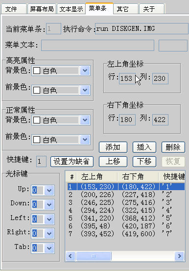

用EasyBoot设置情况(和GHOST80设置都一样,只是执行命令不同而已)
[这个贴子最后由rainyblue在 2004/08/24 05:08pm 第 1 次编辑]

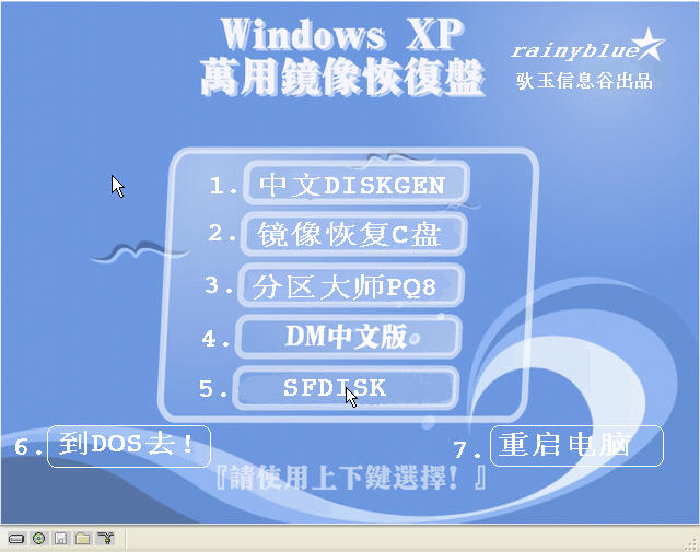

启动介面(自己加进去的SPFDISK和DISKGEN用不了)
[这个贴子最后由rainyblue在 2004/08/24 05:13pm 第 1 次编辑]

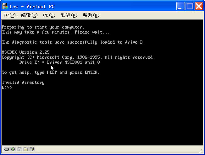

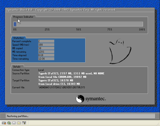

我用Connectix Virtual PC来虚拟
ghost80和其它原有的都能正常启动
DISKGEN和SPFDISK不能正常启动
可能是下面的内容出错了!!
%CDROM%:
改成
%CDROM%:
CD\TOOLS
DISKGEN.EXE
试试!
好的谢谢。我试试。
